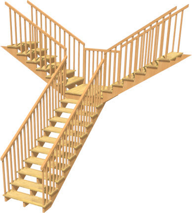

- Click on the landing and drag away from it to produce a stair section that continues upward from the landing.
- Click at a point away from the landing and drag towards one of the free edges not occupied by an existing stair section to produce stairs that build up from the floor towards the landing.

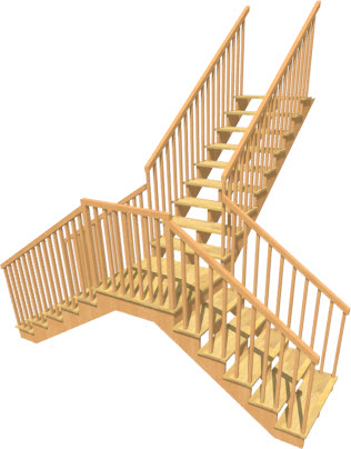

- Select 3D> Create Perspective View> Floor Overview
from the menu to see the results in 3D.
These steps can easily be modified to have two stair sections come up to meet a single 3rd section.
