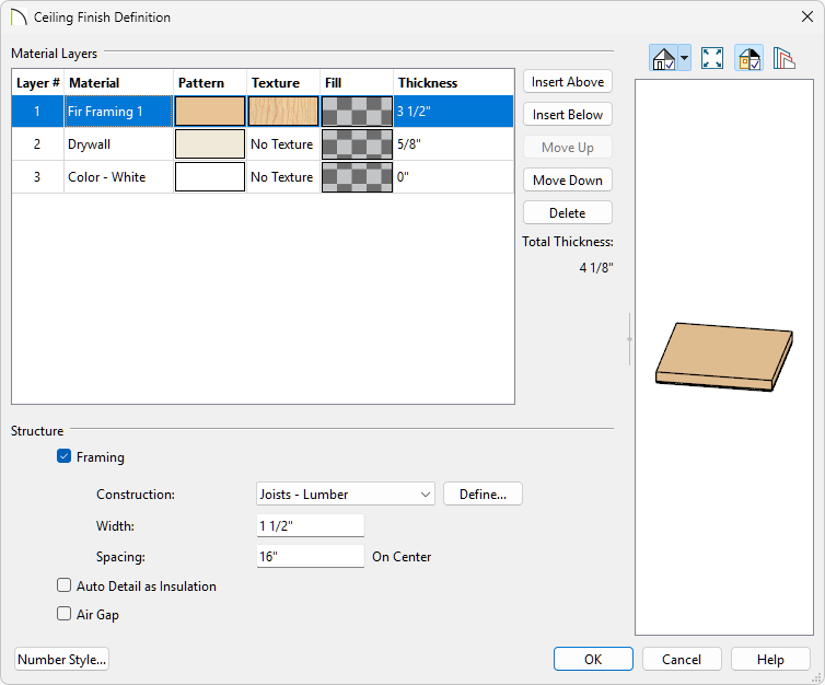

- On the Structure panel of the Room Specification dialog, click the Edit button next to Ceiling Finish.

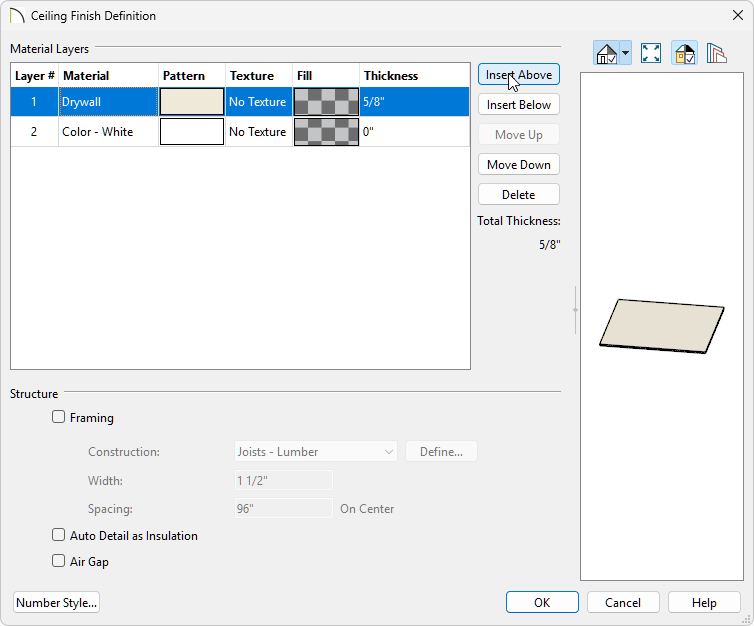

- In the Ceiling Finish Definition dialog that opens next, select the topmost layer, which is Layer # 1, then click the Insert Above button to add a new layer.
![With the topmost layer selected, click the Insert Above button to add a new layer](https://d2haqc5836ials.cloudfront.net/live/KB-01050/1050-InsertAbove-15b.png?1690838955)
- Specify the desired Thickness of this new layer, which will form the dropped ceiling framing.
In this example, 3 1/2" is used.
- Click within the Material column for the new layer to open the Select Material dialog, and choose your desired framing material.
In this example, the "Fir Framing 1" material is used.
- Under the Structure section, check the Framing box for this layer, then specify the Type, Spacing, and Width, as necessary.
In this example, Lumber is set for the Type, 16" is set for the Spacing, and 1 1/2" is set for the Width.
![Framing layer added to Ceiling Finish Definition](https://d2haqc5836ials.cloudfront.net/live/KB-01050/1050-FramingLayer-15.png?1690838955)

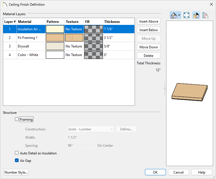

- Repeat this process if you require additional layers, such as an air gap, above the framing.
In this example, an additional layer was added with a Thickness of 7 7/8" and the material set to "Insulation Air Gap". When adding layers, it's important to check that the properties under the Structure section are set correctly. With this new layer, we made sure that the Framing box was unchecked and checked the Air Gap box instead.
![Insular Air Gap layer added to the Ceiling Finish](https://d2haqc5836ials.cloudfront.net/live/KB-01050/1050-InsulationAirGap-15.png?1690838955)
- When you are finished, click OK to return to the Room Specification dialog and notice the ceiling preview on the right. Click OK again to confirm the change and close the dialog.

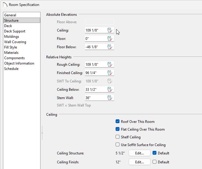

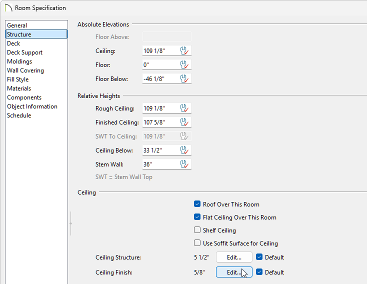

- On the Structure panel of the Room Specification dialog:
![Take note of the Ceiling value under the Absolute Elevations section](https://d2haqc5836ials.cloudfront.net/live/KB-01050/1050-CeilingValue-15.png?1690838955)
- Take note of the Ceiling height under the Absolute Elevations section.
In this example, this value is 109 1/8".
- Click the Edit button next to Ceiling Finish and take note of the Thickness of the layer(s) located above the framing layer.
In this example, the layer(s) above the framing equal a value of 7 7/8".
- Click Cancel to close both dialog boxes.
- Subtract the thickness of the ceiling finish layers above the framing layer from the ceiling height. The resulting value is the top height of your lowered ceiling framing members.
In this example, we subtracted 7 7/8" from 109 1/8", giving us a value of 101 1/4".

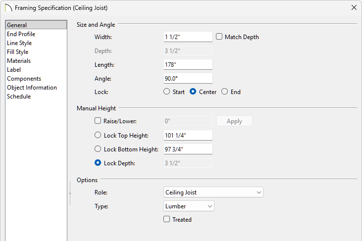

- On the General panel of the Framing Specification dialog:
![General panel of the Framing Specification dialog](https://d2haqc5836ials.cloudfront.net/live/KB-01050/1050-GeneralFramingSpec-15.png?1690838955)
- Specify the desired Width, Role, and Type.
In this example, 1 1/2" thick Lumber is used.
- Specify the desired depth using the Lock Depth field, then click the radio button beside this field to lock this value.
- Specify the desired top height using the Lock Top Height field. Use the value you determined in Step 3, above, which is 101 1/4" in this example.
- Press the Tab key on your keyboard to update the dialog, then confirm that your changes are all correct.

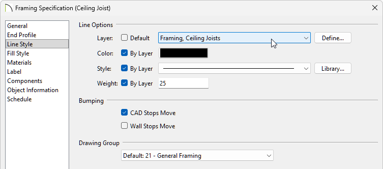

- On the Line Style panel, use the Layer drop-down to select the "Framing, Ceiling Joists" layer from the list, then click OK.
![Line Style panel of the Framing Specification dialog](https://d2haqc5836ials.cloudfront.net/live/KB-01050/1050-LineStyleFramingSpec-15.png?1690838955)

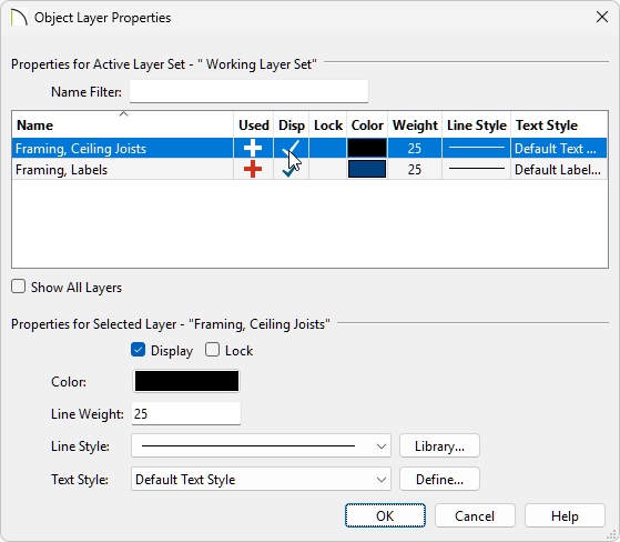

- With the framing member still selected, click the Object Layer Properties
edit button to open the Object Layer Properties dialog, place a check in the Disp column or Display checkbox for the "Framing, Ceiling Joists" layer, then click OK.
![Object Layer Properties dialog](https://d2haqc5836ials.cloudfront.net/live/KB-01050/1050-ObjectLayerProperties-15.png?1690838955)
